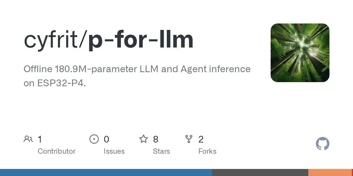

$6.80 (Wireless-Tag store)A 180.9M-parameter MoE language model and agent on a $6.80 ESP32-P4.
By cyfrit
- 8 (GitHub)
- WT9932P4-Tiny (ESP32-P4 v1.3, 32MB PSRAM, 16MB flash)
- PFor: 12-layer MoE (29 experts, top-1) + PLE, 1.58-bit ternary weights, Qwen3.5-pruned vocab
- Est. cost
- $6.80 (Wireless-Tag store)
Custom 180.9M-parameter MoE+PLE model quantized to W1.58A8 (~44 MiB across PSRAM and XIP flash) runs ChatML chat and a fixed-tool agent loop at ~9 tok/s on a WT9932P4-Tiny ESP32-P4 board using Espressif's XespV acceleration.
A 12-layer MoE with Per-Layer Embeddings and 1.58-bit weights lives across PSRAM and flash, running chat and a fixed-tool agent loop at about 9 tok/s.
